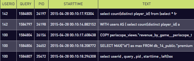

One of the most common reasons to log into the Redshfit console is to kill a misbehaving query. To find which queries are currently in progress, check the stv_inflight table.
  userid
  , query
  , pid
  , starttime
  , left(text, 50) as text
from stv_inflight
You’ll end up with a table like this:
To kill a query, use the cancel <pid> <msg> command. Be sure to use the process id — pid in the table above — and not the query id. You can supply an optional message which will be returned to the issuer of the query and logged.

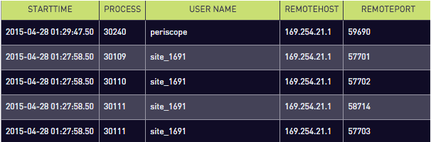

The stv_sessions table lists all the current connection, similar to Postgres’s pg_stat_activity. While useful, it doesn’t have the actual connection information for host and port. That can be found in stl_connection_log. This table has a list of all connects, authenticates, and disconnects on your cluster. Joining these tables returns a list of sessions, along with remote host information.
select distinct
  starttime
  , process
  , user_name
  , '169.254.21.1' remotehost
  , remoteport
from stv_sessions
left join stl_connection_log on pid = process
  and starttime > recordtime - interval '1 second'
order by starttime desc
You’ll get a table like this:
